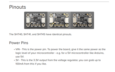

ABans.3
Associate II
I think you are powering the board wrongly. The as per the doument below vin in should be used for powering the board, not the Vo which is meant to be voltage output. Thanks
https://cdn-learn.adafruit.com/downloads/pdf/adafruit-sht40-temperature-humidity-sensor.pdf
Best Regards
Ankit  Bansal
That's exactly what I suspected @LPetr.1 .
Best regards.
