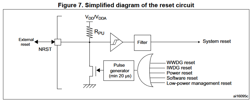

First of all, NRST does not need a pull-up resistor, as was common with MCUs of the last century, because there is already a pull-up in the STM32. However, a capacitor of 10...100nF should be connected to NRST against GND.
Furthermore, NRST acts not only as an input, but also as an output. It can put several internal reset sources as a pulse of about 20µs to the outside circuitry, as you can find in RM0008 under Power Reset. For example, you may have activated the watchdog WWDF or IWDG, which triggers a reset if the watchdog has not been triggered before.

@Peter BENSCH , I agree. In one of my trials, I completely removed 10k resistor and put 100nF. But still it behaved same. I have gone through RM0008 document, and the following scheamtic. It is less likely that any of this happening as I have used brand-new controller on a fresh pcb and didn't een flash any code. From your reply can I assume there's no issue with my schematic? (i mean from VDD, VSS connections point of view). If this still happening.. there might be some issue with PCB itself and may be I can safely go for another PCB manufacturer...
