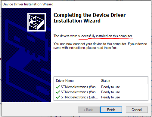

I used the STM32CubeIDE for 3 years on a Windows10 PC. After installing the 8-bit ST_Tools (STM8CubeIDE,...) on the same PC the connection to a NUCLEO-64 (STM32-G431RB) does no longer work. Now STM32CubeProgrammer reports "No ST-Link detected". However, I don't know if the STM8 installation is related to the problem.
Solution attempt: download and re-install the latest STM32CubeProgrammer (v2.11.0) ST-Link drivers (STSW-LINK009). The install wizard reported a successful driver installation (see screenshot). However, the issue"No ST-Link detected" persists, and new drivers are listed by the Windows Device Manager (see screenshot).
Please suggest potential solutions to try. Thank you.
