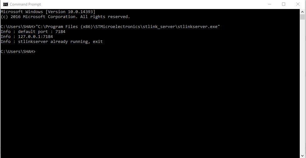

Can you try to launch STLinkserver in a cmd window and share the log.
C:\Program Files (x86)\STMicroelectronics\stlink_server>stlinkserver.exe -d

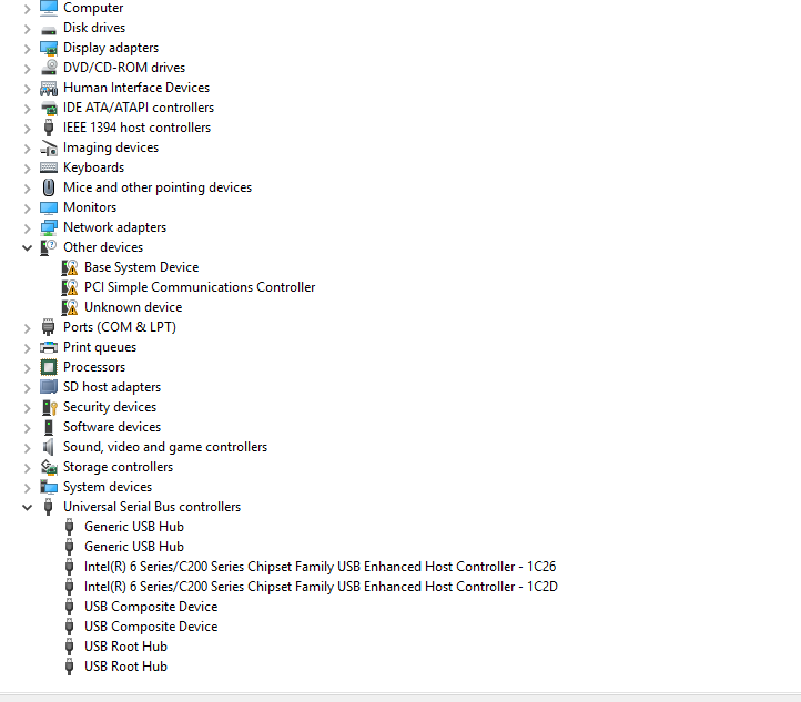

Can you look at the "Unknown device" in devices manager and see what VID and PID it has. If you right click and check properties.
STMicroelectronics has VID 0x483
Seems the STLink usb drivers are not well installed ?

For the stlinkserver, you can kill it if it was already started by STM32CubeIde.
And relaunch it with -d option to have more verbosity.
