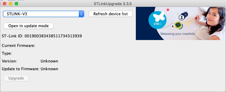

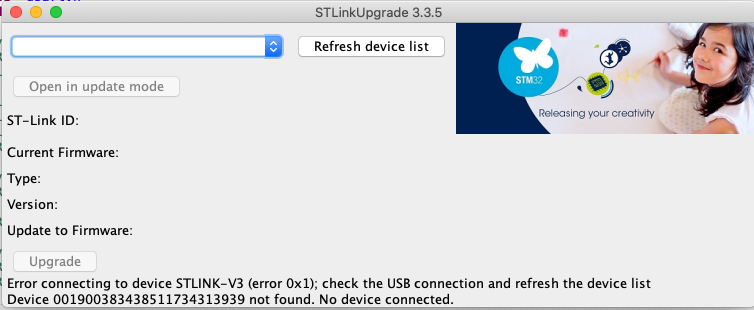

The Nucleo board is connected via USB, I restarted CubeIDE and my mac, but it didn't help. When I try to update ST-LINK I receive such message:

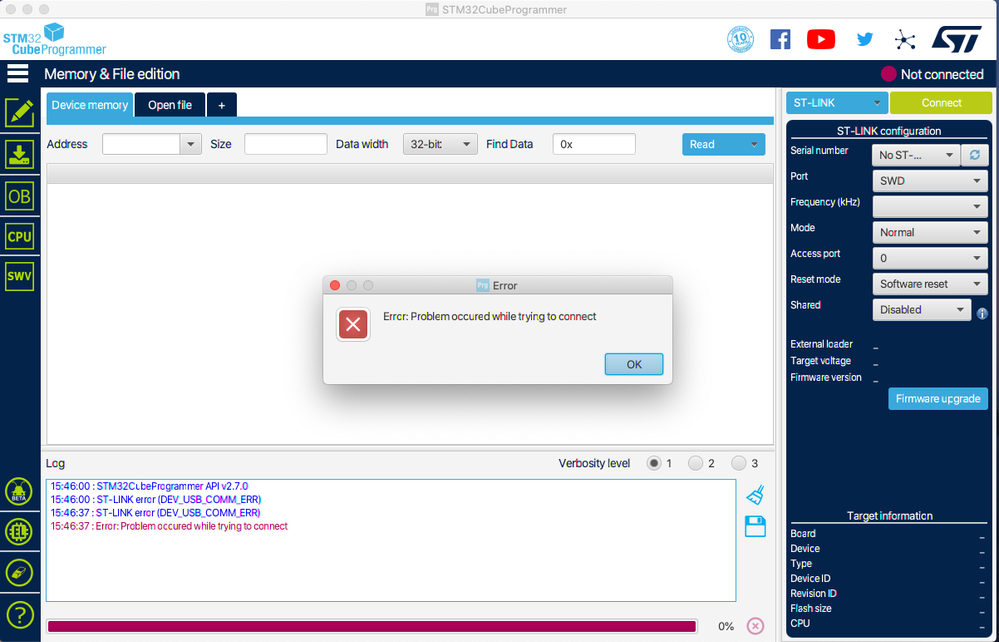

2021-04-28 6:55 AM
Hi Markus,
I just installed and CubeProgrammer and tried to connect, but without success. Please see below screenshot:
I'm using MacBook Pro, so I don't have any USB port. I'm using Thunderbolt -> USB adapter. It works with Nucleo WB55 without any issues. I am able to connect with Nucleo WB55 via CubeProgrammer and Cube IDE. With Nucleo H723ZG I am not able to connect, however Mac sees the board.

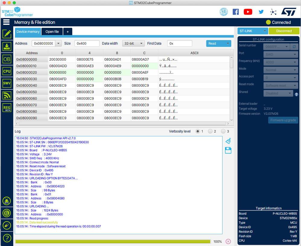

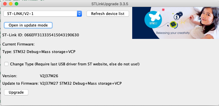

It works perfectly well with WB55, however it's using ST-LINK V2-1, where H723ZG is using STLINK V3. Below screenshots show connection with WB55.
