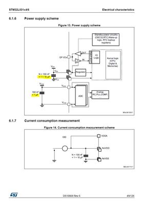

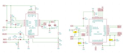

According to the datasheet a 10uF should be considered at VDD and 1uF at VDDA.Are these values mandatory for a robust design? I’ve checked various STM32L0 schematics on the internet and most of them use only the 100nF capacitors.I’m asking this quest...

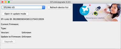

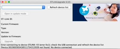

Hi,So far I was using Nucleo WB55 and everything was ok with ST-LINK. Now I created new project and switched to Nucleo H723ZG. When I try to run or debug I receive message:No ST-LINK detected! Please connect ST-LINK and restart the debug session.The ...
