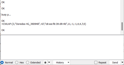

I’m currently working on a project where I’m using an STM32H7B3I-DK board to communicate with Esp8266 WIFI Module using AT commands. I’ve been able to successfully send commands and receive responses using HAL_UARTEx_RxEventCallback , but I’ve encountered an issue with the AT+CWLAP command.
When I send the AT+CWLAP command, On my Serial Port I receive this :
But in my Rx Buffer the first few characters of the response are missing. Here’s an example of what I’m seeing:
\r\nOK\r\n", '\0' <repeats 30 times>, "Ooredoo 4G_39D94B\",-67,\"c8:ea:f8:39:d9:4b\",11,-1,-1,4,4,7,0)\r\n\r\nOK\r\n", '\0' <repeats 1943 times>
As you can see, the response begins with a series of null characters (\0) and the first +CWLAP: is missing.
