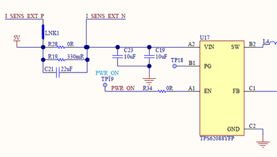

2025-06-04 7:02 AM
Hi again,
I see, in that case do you know what the Nucleo-N657X0-Q equivalent components would be for the R23, R24, and C27 that should be removed for the Discovery Kit?
2025-06-04 7:30 AM
Yes, according to Nucleo schematics at page 9
The equivalent components are: R28, R19 and C21
2025-06-04 7:44 AM
Thank you for that, the last thing I would want is to remove the incorrect component.
Regarding the other solution with R40, I'm assuming that it refers to section 7.4.4 in um3417? If so, for my case where I wish to measure the power consumption of the board when running a neural network model using the stlink-v3pwr, would I also remove R40 and measure pin pair 3/4 or would it in my case be R28 with pair 1/2?
2025-06-04 9:06 AM
The solution with R40 requires to measure the voltage drop using an oscilloscope or other instrument on CN12 3-4 pins. You cannot use a power source such as STLINK-V3PWR to accomplish this.
This solution has the non negligible advantage that the required hardware modifications are less invasive (just remove R40).
