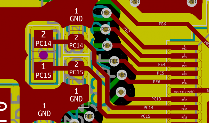

The PCB layout for the LSE crystal. PC15 and PC14 is it mounted at.

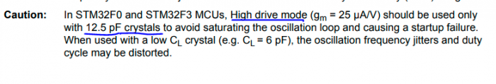

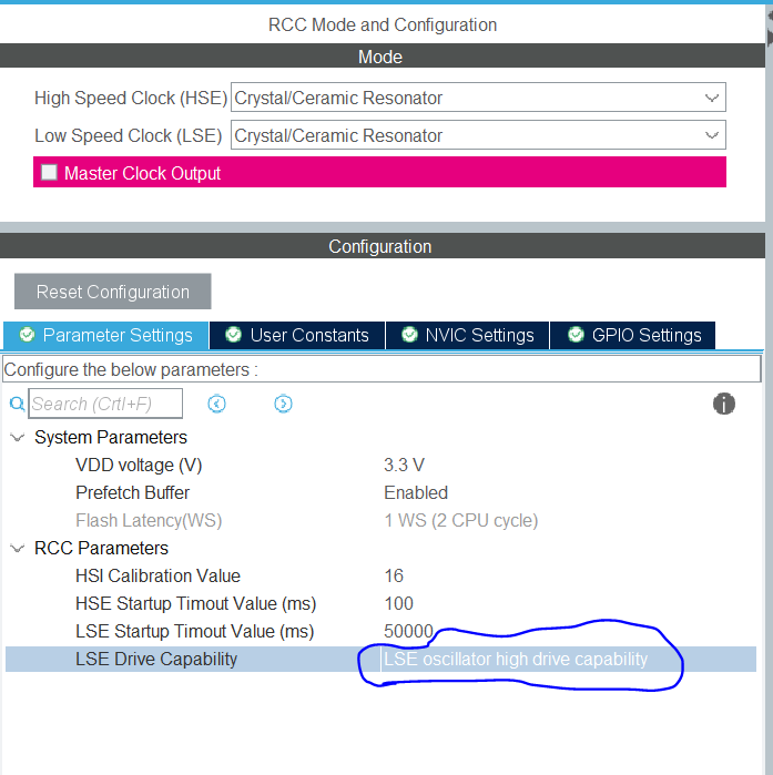

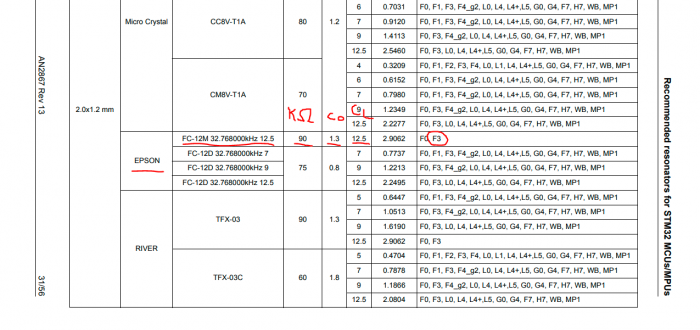

I have followed recommended CubeMX setupI have selected the correct LSE crystal according from the recommendations from ST.

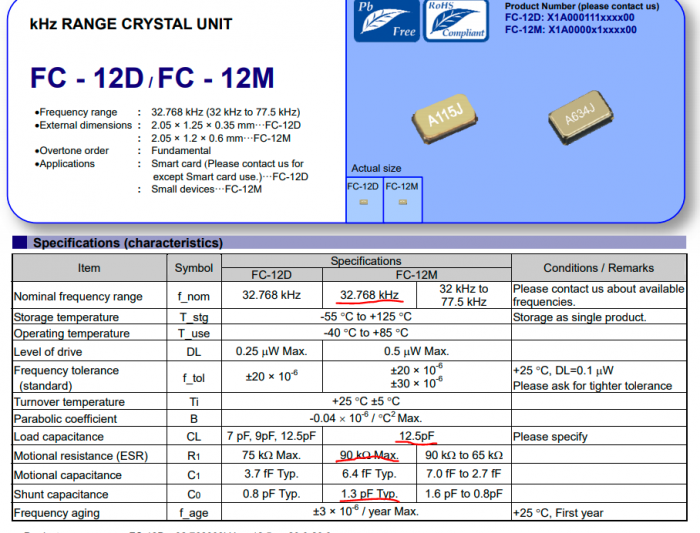

And the crystal information looks like this:

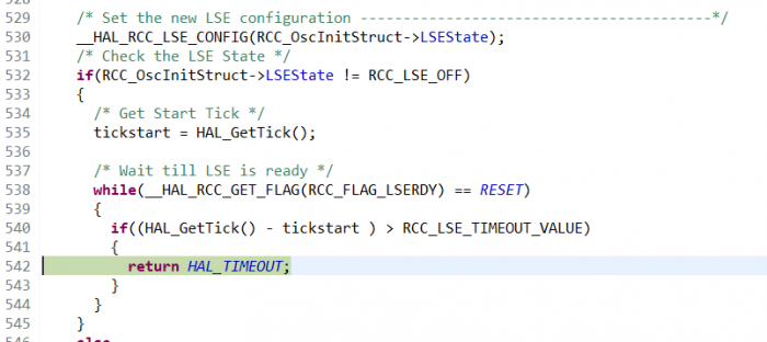

Don't rely on CubeMX, write a very simple app that just brings the LSE up, and routes to MCO or TAMPER (I'm not going to dig the DM/RM) so you can probe it without loading it.
Perhaps there is an RTC example in CubeF3, or something even simpler in the old SPL libraries.
STM32 parts are relatively hard to break, the fact it doesn't start any clocks automatically does make a signs-of-life determination more difficult, but sounds like you have code on it and it runs, just that the LSE fails to start, either at all, or within the time out window.

First, just use the hardware you have, and do what TDK recommended above - write simple code enabling LSE and outputting it to MCO directly by writing into the respective register, and observe.
