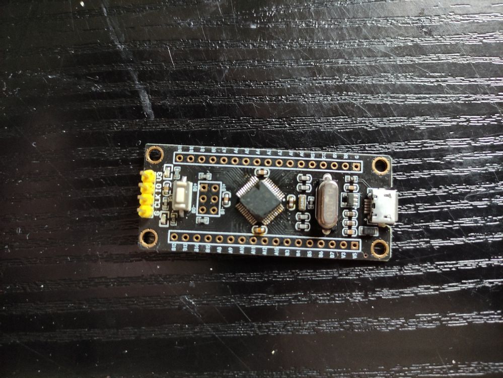

Hi, I have a discovery board stm32f746 with witch i cannot connect anymore on the st-link port.. Windows does not detect anymore the st-link port .. i took out the chip put it on a smal test board and the chip it's ok is detected as st-link... but on the main board does not, i could connect an external programmer on the 4 pins for programming the st-link... but it still not detected by windows. Please help me recover the board.

2021-06-02 8:02 AM
I put the chip on this board and is detected as st-link chip ... but on mainboard does not... the usb port connector is ok, cable changed, pc changed, no matter what the st-link is not detected is like i'm not connecting the usb cable to the pc... no sound no undected hardware or st-link.
