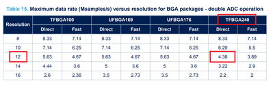

According to my understanding, Disco is based on STM32H745XI (240pin TFBGA). Maximum ADC rate would be only 4.38MHz.
Yes you're right according to the AN5354:
But, unfortunately, there is no other ST boards for STM32H745 with other packages.
The only available ST boards for STM32H745 are with LQFP144 and TFBGA240.
2024-12-19 4:01 AM - edited 2024-12-19 6:34 AM
