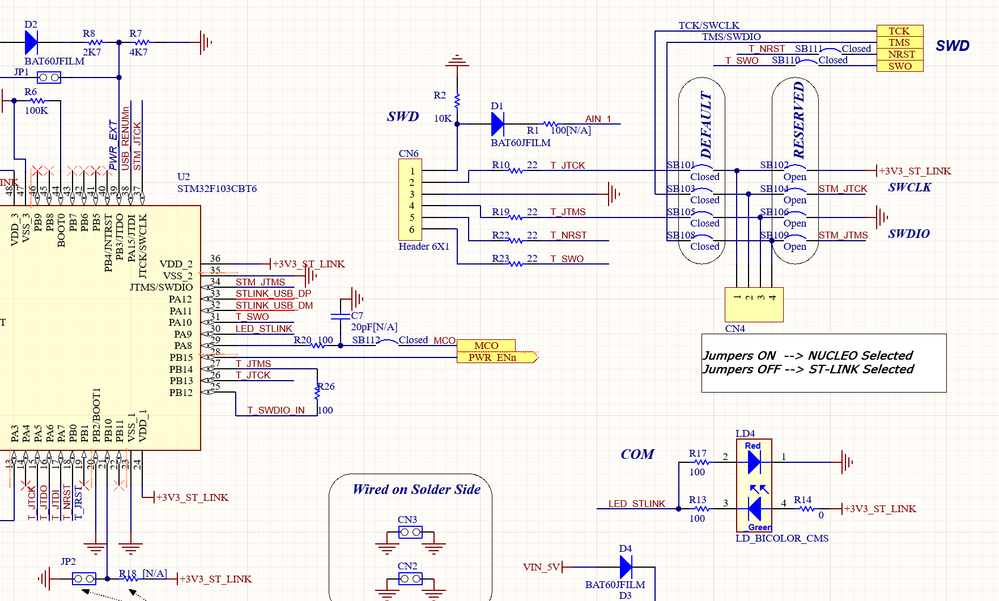

In general this should not be black magic, we've all got some Nucleo boards, which are a great example that programming STM32 with STM32 is possible. On my NucleoF722ZE, the STM32F103CBT6 does the programming. It should receive packets via USB, then program the main MCU via either JTAG or SWD. It has a pair of jumpers - CN4, when closed - the jumper connects T_JTCK with SWCLK, and T_JTMS with SWDIO, and programs the big MCU via SWD interface.
When I look at how these signals are wired, I see this:
PB14 (SPI2_MISO) - T_JTMS - SWDIO
PB13 (SPI2_SCK) - T_JTCK - SWCLK
PB12 (SPI2_NSS) via resistor - T_JTMS - SWDIO
It leads me to think that SWD is done somehow with SPI2 in half-duplex master mode. I've seen people mentioning SPI for JTAG more than once, but I haven't found a good example.
If STM has the code for Nucleo STM32F103CBT6 programmer freely available - that would be everything I need to proceed with my project. But I can't find it.

I've thought about how an SPI port can do SWD and here is my concept that I have not seen implemented. There is a small bit of electrical trickery to deal with the bidirectional nature of SWDIO. Here is the connection:
SPI SCLK ties to SWCLK. This is always unidirectional from host to target.
SPI MISO ties to SWDIO. This allows the host to read the bits sent from the target to the host.
SPI MOSI ties to SWDIO through a resistor, say 1K. This sends the bits from host to target.
The key insight here is that when the target is NOT driving SWDIO, the MOSI signal does through the 1 K resistor. When the target does drive SWDIO, the pin driver is strong enough to overcome the 1 K resistor and the MISO line picks up that signal.
An SWD transaction is 46 bits. For the bits sent by the host, set them to the desired bits you want the target to get. For the bits in the turn around spots, send a '1' and that provides a pullup on the SWDIO line. For the bits the target is supposed to drive, do the same, send a '1'. The target will replace the '1' with the bits it is driving.
Since SWD transaction is 46 bits, send a 48 bit SPI block and put two '0' bits at the end (or the beginning, doesn't matter). SWD transactions start with a '1' bit so the '0' bits will be ignored.
I think the proper CLK settings will be CPHA = 1, CPOL = 0 to get the right edges to clock on, but this is untested.
SWD requires a "reset" sequence of all '1's for 50 bits, so send 56 bits of '1' to achieve that.
I believe you can setup the 6 byte SPI outgoing bits, send them, and then decode the 48 bits you got back to align the response, check the ack bits, and do any bit swapping. (say lsb first versus msb).
The MOSI resistor does limit clock speeds somewhat. Assuming a 20 pF wire loading, that is 20 ns delay on the MOSI to SWDIO signal with a 1 K resistor. This suggests you should operate probably no faster than about 20 MHz, maybe 10 MHz, but this should still be a lot easier and likely faster than bit banging.
This idea is entirely untested, unimplemented, just a concept I had, so let me know if anybody gets it to work.

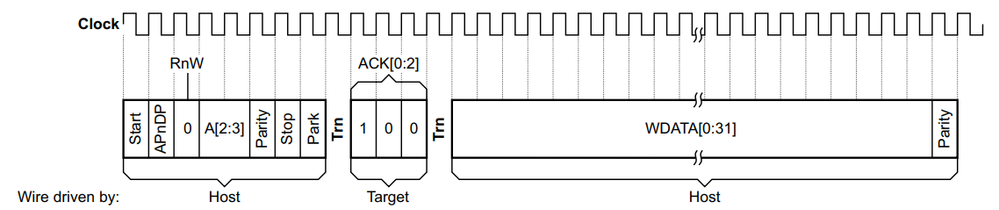

2024-11-11 1:00 AM
SWD is tree parts: - Write some kind of 7 bit address, read 3 bits answer from the device and exchange 33 bits of data with eventually a turnaround bit in between these chunks. Older STM32 SpI can not do the 4 bit transfer needed to read the answer. So either bitbanging is needed for that part. Pin usage on the STLinks lets me assume, two SPI units are used in the STLink.

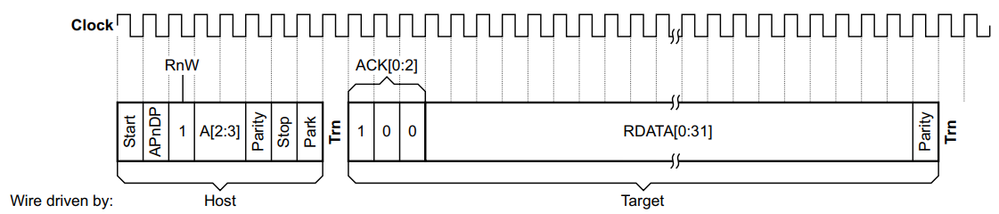

2024-11-11 10:04 PM
SPI is both write and read at the same time. With the resistor trick, MOSI drives the SWDIO through the resistor when the target is acting as an input, and MISO reads the target driving the SWDIO during reads (as well as echoing the MOSI output during write).
The SWD transaction starts with a '1' bit. If you clock in proceeding or trailing '0' bits, they cause no harm and are ignored.
This is a write:
Assuming an 8 bit SPI interface, you send two bytes for the header:
0, 0, 0, Start (1), APnDP, Write (0), A[2:3]
Parity, Stop (0), Park (1), Trn (1), Ack[0:2] (111), Trn (1)
You can now look at the ack bits and if you get the OK response (100), then you proceed with the data write in 5 bytes:
Wdata[0..7]
Wdata[8:15]
Wdata[16:23]
Wdata[24:31]
Parity, 0, 0, 0, 0, 0, 0, 0
If you get the WAIT or FAULT response, handle them as appropriate.
The leading zeros in the first byte and the trailing zeros in the last byte are ignored and are harmless.
This is a read:
The header is bit shifted one bit later due to not needing a Trn between ack and data:
0, 0, 0, 0, Start (1), APnDP, Write (0), A[2]
A[3], Parity, Stop (0), Park (1), Trn (1), Ack[0:2] (111)
You can now look at the ack bits and if you get the OK response (100), then you proceed with the data read in 5 bytes:
1, 1, 1, 1, 1, 1, 1, 1
Parity, Trn (1), 0, 0, 0, 0, 0
The MISO line will clock in the target read back response while you are clocking out 1.
You don't need to do any bit banging, just clever alignment of SPI bits. There are some wasted clock edges, you clocked 56 bits to handle a 46 bit transaction, but that's relatively minor overhead to get the benefits of using the SPI peripheral to clock things in without bit banging.
Mike C.

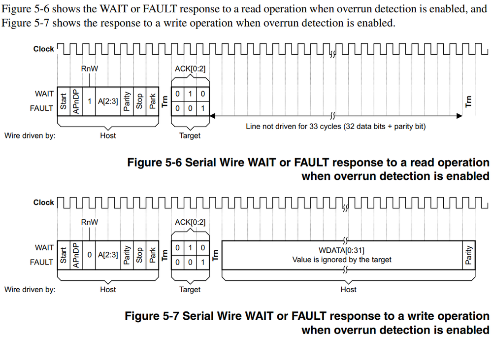

2024-11-12 2:24 AM
The resistor trick will not work when voltage translation is needed. Otherwise, if the device signals wait or error, the protocoll tells not to do the (R|W)DATA transaction and doing the transaction despite may upset the device. This may require reinitialization. So only a four byte transaction to read "ACK" allows to stay in the protocoll.
2024-11-12 5:39 AM
Voltage translation occurs at the MISO, MOSI levels, then do the resistor in the target voltage domain. MISO, MOSI are unidirectional signals, so easily translated. This can occur even after isolation, say after ISO6xxx isolators are used which provides both isolation and target voltage translation.
Once you do the first two bytes, which have the header and ack bits, you can check the ack codes and respond to them. A WAIT or FAULT response means you don't do the data portion unless you have overrun detection enabled, then you do a data portion. The alignment of the SPI bits is done precisely so that you can stop after the ack bits.
You could always enable overrun detection and then always have a data portion.
If you have a protocol error, the target provides no ack bits, then do the resync procedure (send 50 1 bits which can be 6 '0' followed by 50 '1' to make it work with 8 bit SPI) and then read the IDCODE register. Now you are back in sync.
