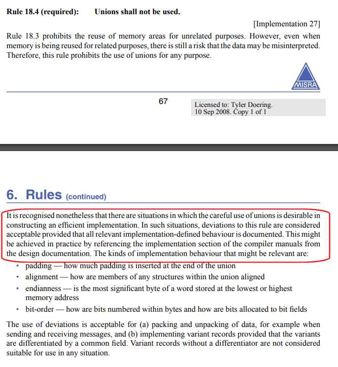

I'm asking this question because I have compilation warning inside a library that I included in my project. And inside the source-code of this library, there is a mention about rules of C MISRA-2004 that are not respected.
Here is the mention :
The warning concern an union (like Rule 18.4 that is not respected).
Here is the warning :
C:/Users/xxxx/ST/BlueNRG-1_2 DK 3.2.3(v4.0)/Library/CMSIS/Device/ST/BlueNRG1/Include/BlueNRG1.h:1541:5: warning: no semicolon at end of struct or union
1541 | } CLOCK_EN_b;

So I read the rule 18.4 of MISRA C 2004 compliance, and surprisingly, I didnt fount any
information and how a union in a struct should be write in code.

2024-04-05 6:42 AM - edited 2024-04-05 6:43 AM
Have you actually read the MISRA document?
So the notes you've seen in the CMSIS Library comments are just fulfilling that requirement to document this deviation from the Rule.
This is acceptable.
2024-04-05 6:52 AM
As I said, I did read this rule.
But that doesnt really answer my question : is stm32cubeIDE use C MISRA 2004 Compliance ?
I dont know why I get a warning from the struct I provided (from the source-code).
2024-04-05 6:57 AM
@q3z85d41xqz036d wrote:But that doesnt really answer my question : is stm32cubeIDE use C MISRA 2004 Compliance ?
Yes, it does answer the question about MISRA compliance - it meets the compliance criteria of documenting what it does.
@q3z85d41xqz036d wrote:I dont know why I get a warning from the struct I provided (from the source-code).
Where does that warning come from? It looks like just a compiler warning?
Compiler warnings are nothing to do with MISRA compliance.
