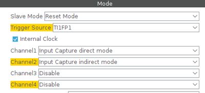

2024-03-12 9:14 AM
Hi
In my opinion this is an obvious bug in CubeMX.
I have exactly the same problem with STM32F303 (nukleo32)
Only setting CH2 as in the attached picture fixes the problem.

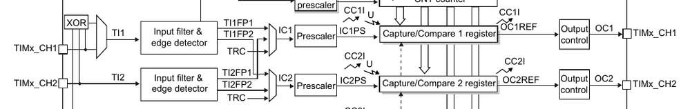

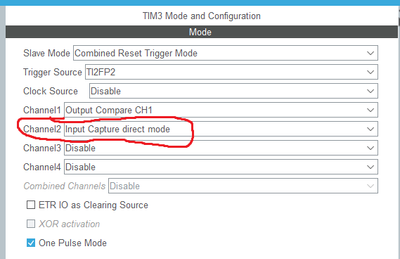

2024-03-12 10:19 AM
i see no bug in Cube here . :)
see (any) timer :
TIMx_CH2 pin is same pin , connected to input and output of capture/compare channel (2 here).
If you want the TI2FP2 signal (for trigger etc.) , the channel has to be set as INPUT . (direct input mode)
Here i set it in Cube (ch1 + ch2 used as inputs):
Not setting as an input might do then, what @HWhit.1 found : OC output appears at the pin...
(If Cube would be perfect, it should show a warning: "Set used channel as input, to use input signal TIxFPy." )
