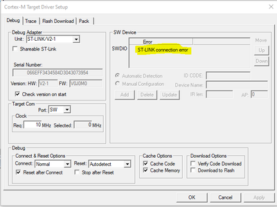

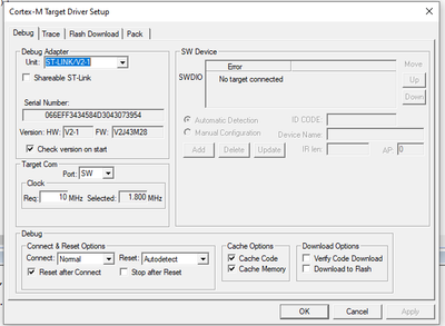

After using the board for a couple of days, the board started giving the following error is Keil-MDK:

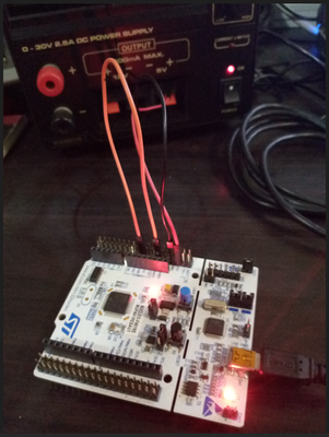

And the two led's (LD1 & LD3) are always RED as shown below:

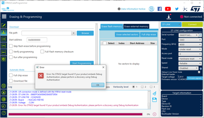

I tried also to put the chip into loader mode (as shown above) by shorting the VDD pin and the BOOT0 pin but I get the following error from the STM32Cube Programmer when trying to connect to the board:

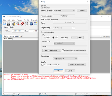

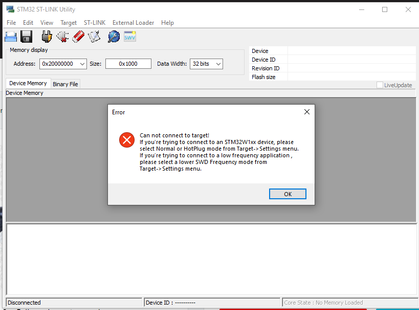

I tried also to use the STM32 ST-LINK Utility but also get the following error when

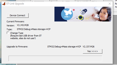

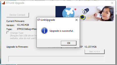

But if i try to do a firmware upgrade (ST-Link Upgrade), it can perform Device Connect and upgrade to the recommended firmware:
But still can not connect via STM32CubeProgrammer and the ST-LINK Utility tool. But on Keil-MDK i get a different Error:
Can someone assist if the board is damaged or there is hope it can still be recovered.

LD1 being solid red indicates successful USB connection. LD3 on is normal.
You need to reset the device while BOOT0 is held high. Did you do this as well? You should be able to connect after that.

And even in Keil still giving the same error:

Ans: I was only testing to see if i can connect to the ST-LINK and upgrade its firmware. Not sure if upgrading firmware reassigns SWD pins or put the device into low power modes.

@TDK , I tried the steps you indicated but still not connecting. I even tried powering the board from E5V using the 5V power supply and connected VDD to BOOT0 pin and RESET but still not connecting.

@TDK thanks for the assistance. No I did not upload any firmware during the few days of using it. The version of firmware that was running was the V2.J37.M26. Only started uploading firmware when the board started not connecting to the Keil-MDK.

Is there a way to troubleshoot where the problem can be, suspecting the STM32F401 microcontroller is damaged or not connecting to the ST-Link part of the board. Because the ST-Link part of the board is working as i can upgrade the ST-Link firmware.
