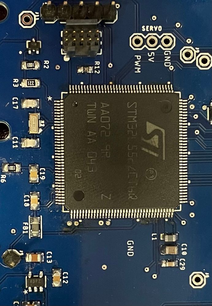

Will do. In the meantime though, I might have found something. There's an 100k ohm resistor between the NRST pin, and the rest of the SWD connection. The SWD side of the resistor is being pulled low, but is it possible that the MCU side of it is still being held high by the internal pull-up? It looks that way based on the multimeter I'm using, but it could just as easily be too slow to pick it up.
Edit: Here's the photo you asked about. The resistor I mentioned is R6

There's an internal pull-up, probably 10K type magnitude
Picture seems to check out, right part, markings, orientation.
Not a SMPS user here so not sure expectations, but would suggest double checking outputs meet expectations.
