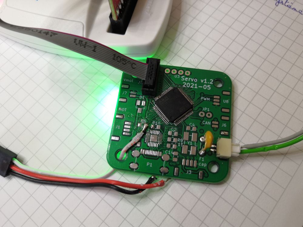

>> Can you take a picture of the IC on the PCB? Points for clear, sharp and in focus.

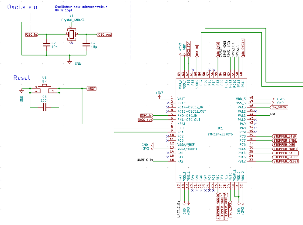

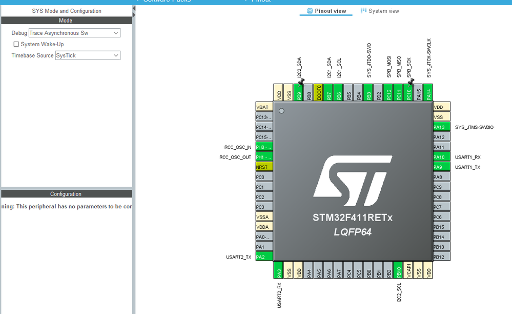

Here is a part of my wiring diagram, the stm32 CubeIDE configuration and a picture of the board. Pin 1 is on the bottom right. BOOT0 is given to a 10k Ohm resistor for which I can choose to ground or 3.3V

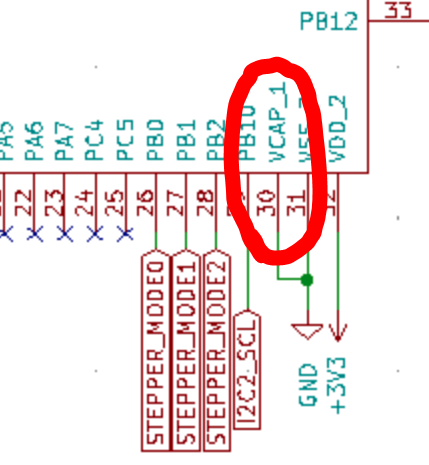

You've grounded VCAP. That will cause the chip to not function. This pin outputs ~1.2V and needs to be bypassed to GND with a ~2.2uF cap.
Review the reference layout documentation.
Tesla asked you about this in the very first post.
> Check voltage seen on VCAP pins, and placed caps.
Edit: Not only that, but you replied and said that you've checked it.
> I have already checked all this

Sorry I didn't see this feature in the documentation. I unsoldered this pin and soldered a 2.2uF capacitor as indicated. Now the card consumes much less and the value seems to me more coherent (10mA instead of 150mA).
I still can't connect to the board but I will read the documentation more carefully before coming back to you.

After looking at your picture again, the only thing you have populated is the STM32 and F1 and some cables. Might need some decoupling caps on there before it acts correctly. I guess there may be components on the other side.
2021-12-16 7:02 AM
Yes, I will order a new card changing the Vcap pin and putting a 4.7uF capacitance (because only one Vcap if I understood) and putting all the decoupling capacitance requested for the power supply. Yes I have components on the other side, and the board is printed on 4 layers.

I received my new PCB yesterday, after soldering it managed to make the board work.
I corrected the problem with the capacitance on Vcap and the decoupling capacitance on each power supply leg of the microcontroller
