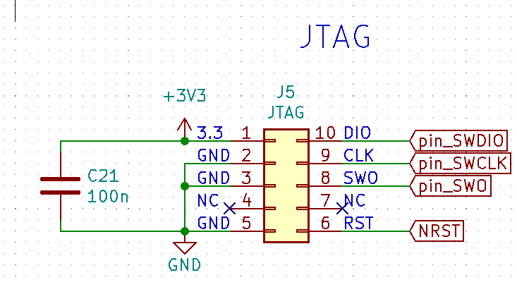

For a project, I created a PCB with an STM32F411 using a 10pin JTAG port for SWD programming.I tried to connect my card using the ST LINK V2 box and the ST Link utility software but I get the following error:
The st link works because I can program another card using a stm32F042. I tried all the connection parameters and to play with the BOOT0 pin status but nothing works.
Can anyone help me to program my card?

So F4 in the circuit is non functional, focus on that and wiring to it.
Check part orientation.
Check voltage seen on VCAP pins, and placed caps.
Check VDDA
Check NRST

Well check again, because something is wrong and most likely it's a hardware issue. How is the board powered?
The pinout you showed is correct.
For a debug header, but the chip needs to be functional to be responsive.Right now seems dead in the water unless any other signs of life can be determined.
The other secondary method is to probe one of the System Loader's UARTs responds to the 0x7F data pattern at 9600 8E1, in the BOOT0=HIGH cases.
Focus on causal reasons why chip is dead in the water...

We have zero visibility into this, assume your design is flawed. Have someone you work with do a walk thru of the design and data sheets with you.
Review the pin assignments, and net list.

Posting the entire schematic instead of just the debug port pinout would also help. The pinout you show is correct but that doesn't mean the rest of the design is correct, or that those signals are connected to the correct pins on the chip.
