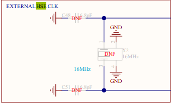

Just - there is no HSE crystal !
from -> https://www.st.com/en/evaluation-tools/nucleo-u385rg-q.html#cad-resources

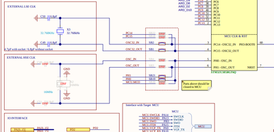

see circuit:
Clock coming from st-link, so set hse bypass and it should work. (with default solder bridges )
And maybe do update the st-link, there you can decide which clock is coming to the U385 , 16M probably.
So it only can work with powered and running st-link cpu; if you want U385 having its own clock,
you have to solder the missing parts, 16MHz crystal and caps, and adjust the solder bridges to have the crystal connected and st-link disconnected.

as you can see in the board scheamtics the HSE clock is not implemented for cost reduction purposes
you didn't find any problems with the Nucleo-C092RC because the board supports a HSE buy default
you can use the Bypass mode to use the HSE clock of the STlink but check the frequency

Thanks a lot for your feedback and for your welcome to the ST Community. Now I understand that indeed there is no external HSE oscillator (x2) from the circuit diagram. Inspection of the board confirms this.

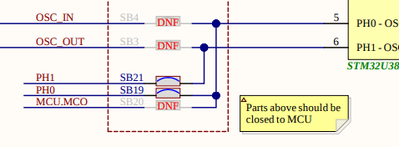

see circuit:
So sb19 closed, as it was. then you get the MCO from the st-link.

I agree that the circuit diagram implies that PH0 should be available to the U385 MCU. The connection of SB19 is indeed present on the board. The manual of the board is a bit ambiguous, but I will go with the circuit diagram, because that appears more reliable. I did not make or break soldering connections, so the original board is used.
I tried measuring the PH0 pin, but still got no signal.

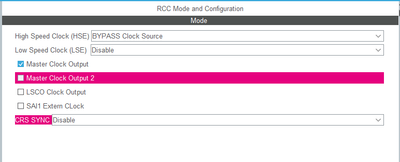

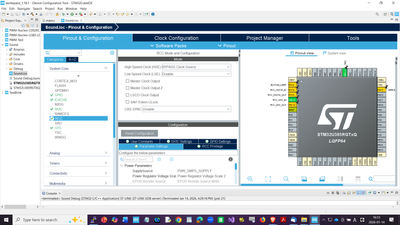

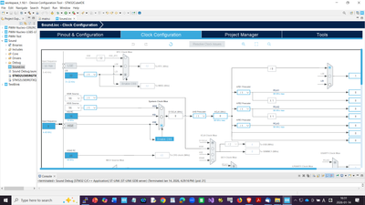

I attach two screen shots to show my clock tree and the RCC settings.
Am I doing something wrong here?

to visualize MCO, you need to enable it in the .ioc file then track it buy using the PA8 pin
after ensuring that all necessary solder bridges are closed
BR
Gyessine

I dont think so, if sb19 still connected/soldered you should see the clock there, check with scope.
If nothing here...cpu cannot work on HSE (= zero ).
But see: from the clock tree and whats on the board: this cpu should be used with the internal MSK/MSIS clocks,
as only they can generate up to 96MHz (and can have PLL from 32k LSE crystal, which is on the board.)
So I wouldn't concern myself further with the HSE clock ( if there's no clock signal at SB19 anyway) and
use the MSIS clock and set it to the speed i want.
