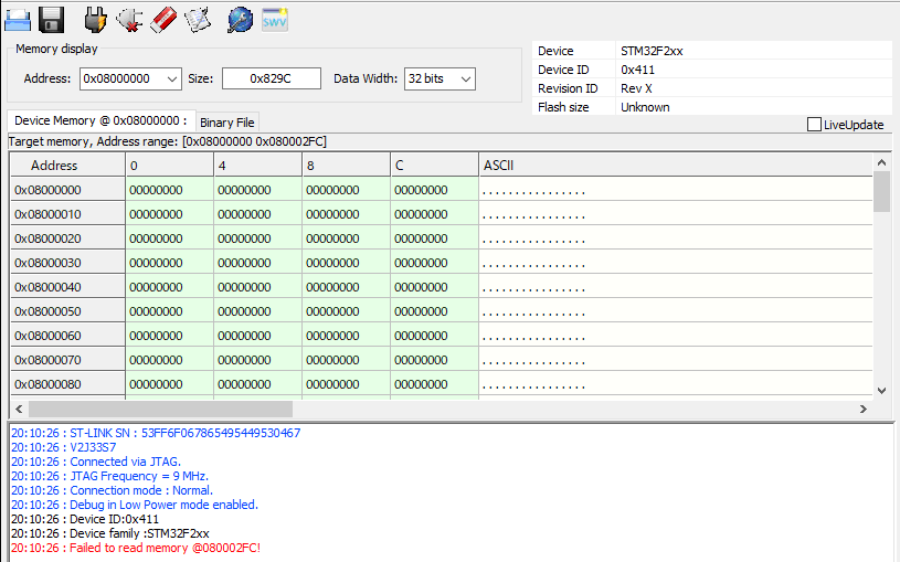

I performed "Target"-> "Connect" of ST-LINK Utility, but an error like an image occurred.
I tried looking for similar errors but it did not solve them.
Please give me a solution.

Hi.
Try to decrease the JTAG frequency from Menu->Target->Settings or /and try to change the Reset Mode from HW to SW.
Check also at Menu-> Target->Option Bytes if Read Out Protection is enabled.
As third option, reconnect device with SWD port to STLink (SWCLK,SWDIO,GND).
if stlink insists to stop reading at 0x080002fc flash address, indicates a HW error.

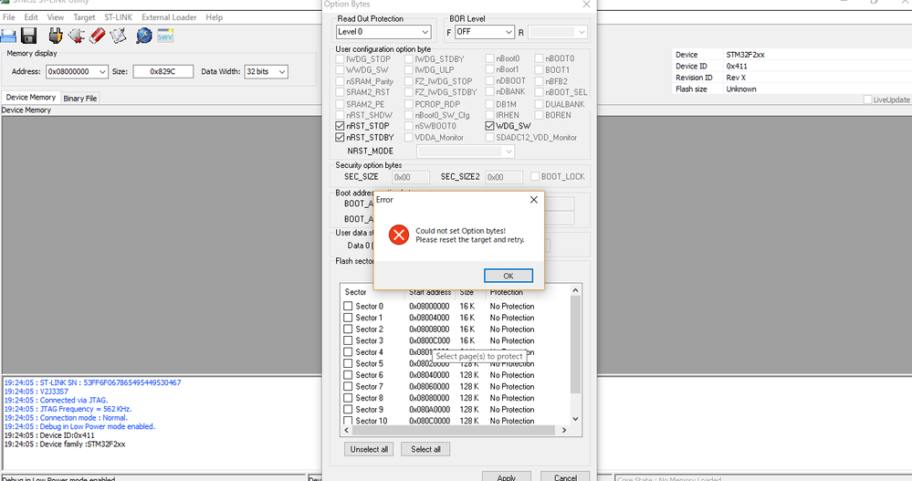

[Option Byte] → [Read Out protection] was set to [Level 1].
I tried to change to [Level 0] but an error occurred. (I think that's because Connect has not been completed.)

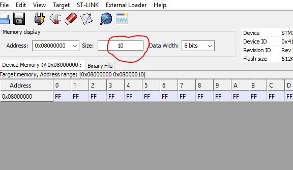

OK. Try not to read so much bytes but change it to eg 16 as below.
After change the RDP or just full erase chip.

Thank you, I tried.
However, when I try to change RDP, I get such an error.
