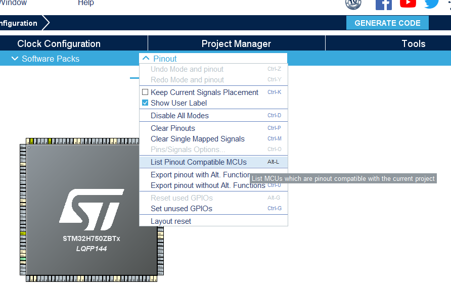

Thank you. That was a good and full answer
That menu item "List pinout compatible MCUs" was in different place than I thought, but I found it anyway.
