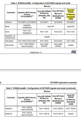

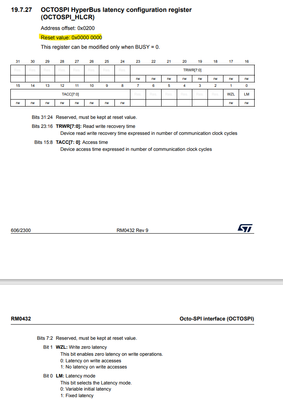

To clarify my last reply, the latency is not available when Octo-SPI or Quad-SPI mode is selected. Because the latency is supported with hyperBus protocol. The latency can be configured via the OCTOSPI HyperBus latency configuration register (OCTOSPI_HLCR). The reset value is 0x0000 0000.

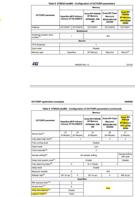

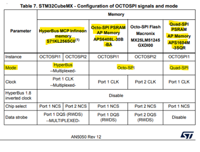

->The AN5050 defines the latency mode for octal-spi PSRAM as "N/A". So, how can I know the default mode?
In AN5050, the mode using with PSRAM APS1604M-3SQR is the Quad-SPI mode and the mode using with PSRAM APS6408L-30B-BA is Octo-SPI mode.
You can choose the mode depending on memory datasheet.

Hello @JKim.2,
The latency is supported with hyperBus protocol as mentioned in reference manual section 19.4.5 HyperBus protocol.
To configure the PSRAM on STM32L4P5G-DK board, I recommend you to follow AN5050 section 7 OCTOSPI application examples.

Hello @KDJEM.1 ,
Thanks.
