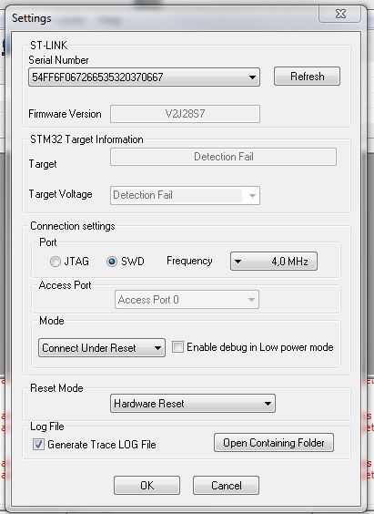

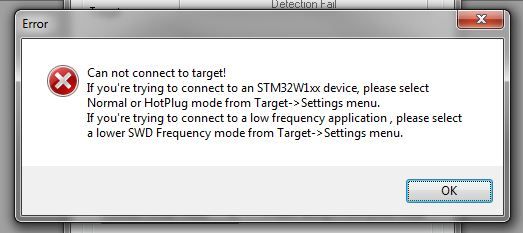

Here is what I get from STM32 ST-LINK Utility :
I got the error :
ST-Link/V2 device detected
Target voltage detected: 3.252984Driving NRST lowError getting target IDCODE: if SWD, check SWD connectionError (4) while initializing ST-Link in SWD modeI tried every SWD frequencies possible.
