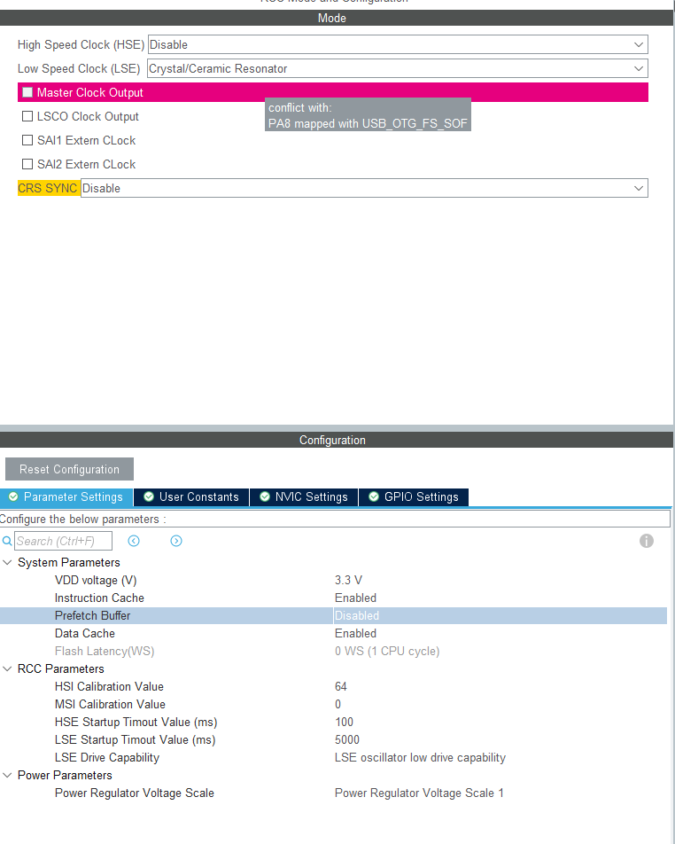

I entered an inifite loop at the HAL_RCC_OscConfig (l 29) of SystemClockConfig()

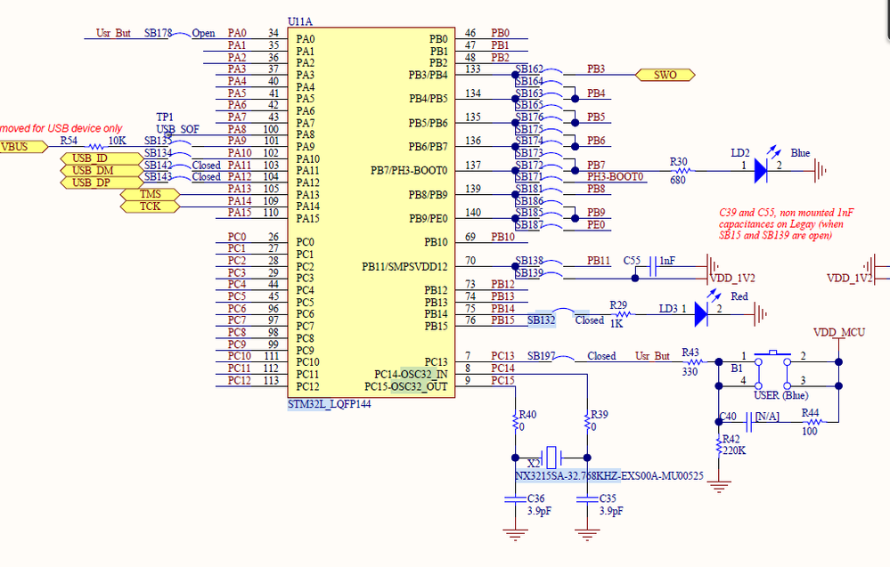

}I thought this cause bay be the setting of the RCC configuration mismatch actual board (STM32L496 demo board: NUCLEO-L496ZG) ,but I can't find correct configuration setting on condition of using on board crystal resonator X2.

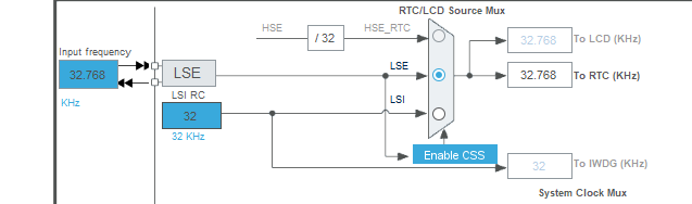

In the initialization of RCC Oscillators, it seems your PLL is not configured!

set LSE drive to high .
