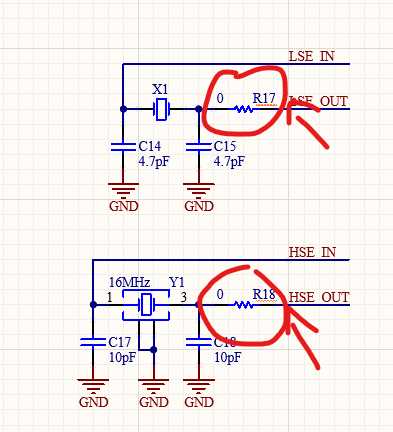

2. As for the HSE oscillator, I think it makes sense to use an external oscillator, but I haven't figured out how to calculate the limiting resistor to put in series. This:
I've read the application note, but it talks about using probes to make measurements, I would like to understand how to calculate this resistance or if there are standard values to use. I have seen that often it is not put at all, other times a resistance in the order of 100 ohms is added.

2023-01-17 6:31 AM
Yes, I read that document, but it says that to understand whether or not to insert that resistance, you need to make measurements with a current probe. I haven't created the board yet, so I can't make measurements, I was interested in an analytical solution.
Also in that document there is also a list of recommended crystals, but what resistance value to insert is not specified.
That document is good from a theoretical point of view, but practically does not say much.

2023-01-17 9:17 AM
Thanks for the answer, but even in this discussion he says that to be 100% sure you need to take measurements.
But to be 100% sure, you should carry out the measurement according to section 3.5.1 (drive level).From what I understand there is no analytical solution to understand if this resistance is needed or not.

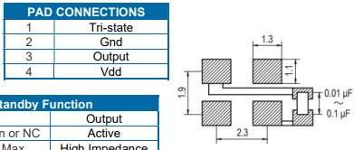

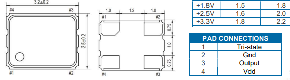

no crystal, use crystal oszillator. no headache.
like this: 16M , about 1 eu.
https://www.mouser.de/ProductDetail/ECS/ECS-3225MVLC-160-BN-TR?qs=Znm5pLBrcAL4nJMogCPInw%3D%3D
2023-01-17 2:20 PM
I don't know this type of component, it has only one output pin, how should I connect it to the microcontroller?
Just connect the output to the HSE in ?
It need other components (series or parallel capacitors, resistors, ...)?
Should I leave the HSE Out pin floating or connected to ground?
2023-01-17 3:12 PM
come on - read the data sheet. this is a chip + crystal, get 3.3v , output xx MHz square wave.
expensive , many y ago - now better than using crystal and caps and worry about resonance ...
set Cube -> HSE to bypass clock . (is for osz. ) only input for clock. 1 pin. out is free to your use .
pin 1 to VDD (enable)
