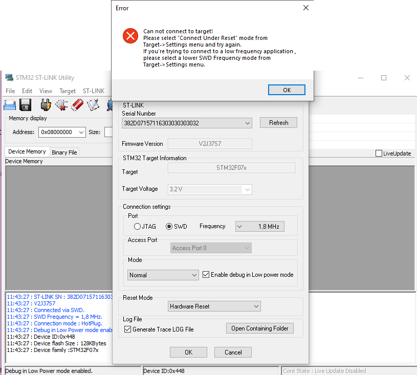

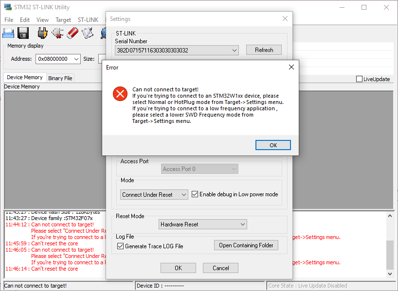

Normal Mode with Hardware Reset needs the nRST pin wired to the debug probe which you don't have.
The ST-LINK utility is superseeded by STM32CubeProgrammer software which comes with a nice User manual (UM2237)
hth

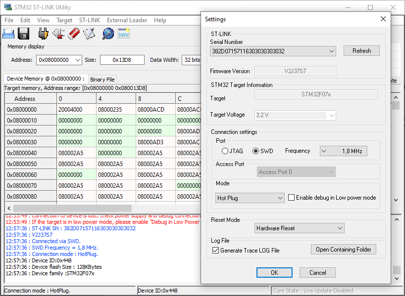

2023-01-19 4:16 AM
!!!!Perfect!!!!
Thank you for your fast response working as expected.;)
