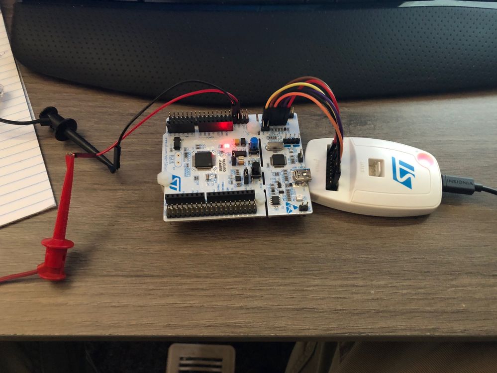

I am trying to connect my ST-LINK/v2 to a Nucleo and having difficulties -
Apparatus
Here is my apparatus config, using Vdd=3.3V -
Here is my wiring config (CN2 jumpers open) -

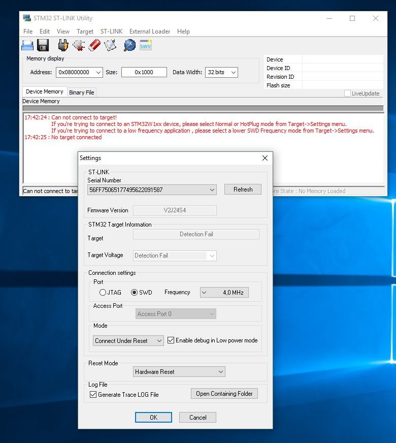

Here is my utility config when I try to connect -
Why isn't this working, thoughts?
2018-08-28 6:11 PM
I connect my Nucleo directly to the USB port on the PC...
2018-08-28 9:42 PM
You are using the 'embedded' ST-LINK, I am referring to using an 'external' ST-LINK.

did you remove both jumpers on CN2 ?

Both CN2 jumpers are removed. I found this useful ref -
I was not able to get this working with either the external ST-LINK/v2, or my Segger J-Link. Thoughts? I have tried both Nucleo-USB power and external power.

2018-08-29 6:10 PM
I've cover this topic several times already.
The header you're using doesn't connect to the Target properly
Connect SWDIO and SWCLK on the TARGET side of the CN2 jumper/header, review the schematic it will help understanding the connectivity.

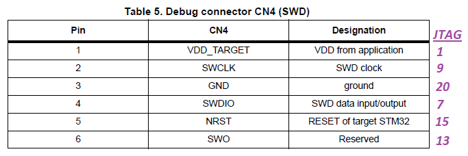

According to the pdf, you can use the Nucleo/Discovery's built-in St-Link to program an external chip via the SWD CN4 connector (remove CN2 jumpers).. but what advantage is there to using an external StLink-V3/J-Link to program the Nucleo/Discovery's STM32?
In any case, to do it, looks like you'd have to remove the CN2 jumpers, but connect your external stlinkv3 to the Zio/Morpho/Arduino header(s).

The target's SWDIO and SWCLK are exposed at CN2.
