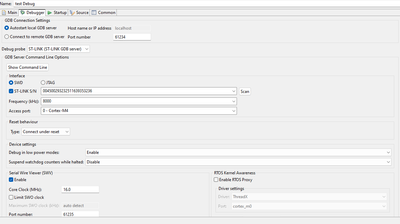

I am trying to connect to the processor STM32L431CCT6TR via SWD connection, but it says no device found. Blowe, I have pasted the message and debugger setup information. It is able to find the debugger. I have also attached the schematic if

STMicroelectronics ST-LINK GDB server. Version 7.4.0
Copyright (c) 2023, STMicroelectronics. All rights reserved.
Starting server with the following options:
Persistent Mode : Disabled
Logging Level : 1
Listen Port Number : 61234
Status Refresh Delay : 15s
Verbose Mode : Disabled
SWD Debug : Enabled
InitWhile : Enabled
Target no device found
Error in initializing ST-LINK device.
Reason: No device found on target.

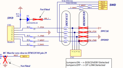

Here is the connection that I had used. I had removed the jumper, so I can communicate.
