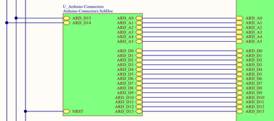

ADC and TIM/PWM pins would likely be exposed via the Arduino Shield connector. Check the board User Manuals, and Schematic (under CAD Resources). Pin level functionality can be found in the STM32H747 Data Sheet

You mean the following connection:

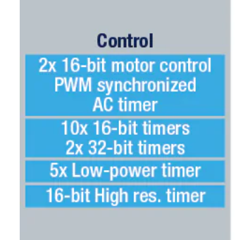

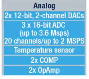

The number of pins for ADC is insufficient only six (I need at least 10 ADC). However, MCU is very rich with the following features
The number of DIO pins is acceptable for the PWM application. However, ADC is limited.
Also, the pin number is not shown to see its functionality.
Could you guide me to increase the ADC pins?
