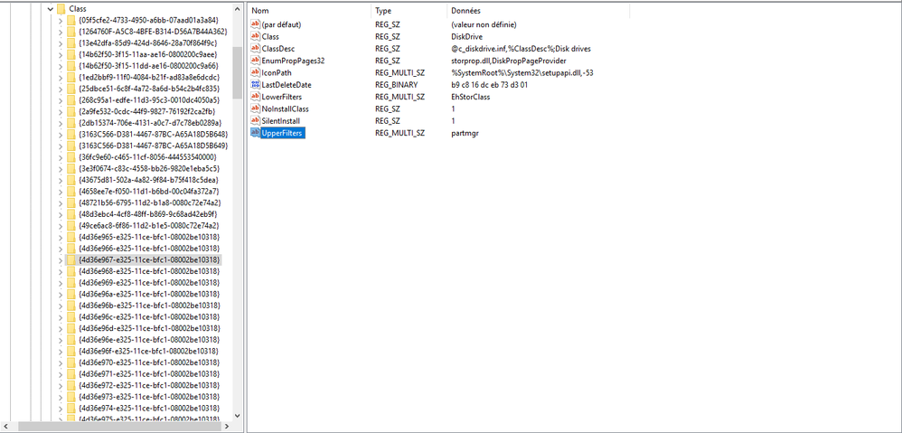

2018-04-11 11:01 AM
>>What do you mean ?
Dell Laptop vs Acer Desktop vs HP Workstation

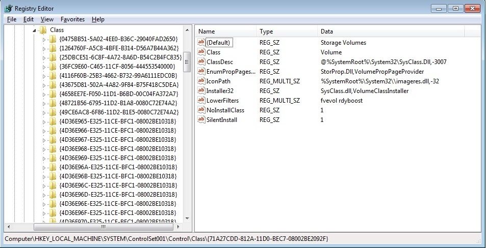

I'd use REGEDIT, or whatever, and search HKLM for ''UpperFilters'' and ''LowerFilters''
