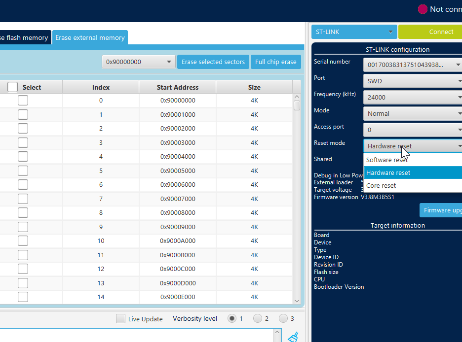

2022-08-12 6:02 AM
I had the same issue after flashing a corrupted build.
The solution is to select Hardware reset under Reset mode in STM32Cube Programmer
