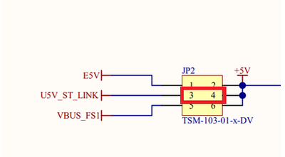

Ok thank you for the confirmation. So, check you have JP2 is at the position 3-4

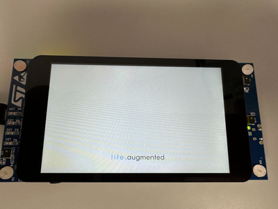

However swapping between several USB hubs and cables I found a combination that did work and I was able to program the board ok. However the demo is a bit underwhelming...
I'm guessing some of the third party assets weren't included in the build for the STM32469I-Disco_Demo_V1.2.0_FULL.hex binary.
Anyway the board works, which was the main point of the exercise.
