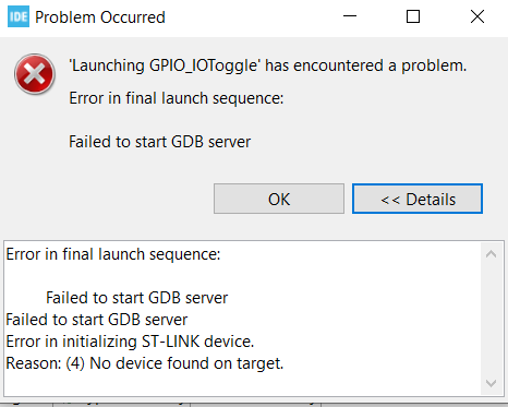

I am using an STM32G031 Nucleo 32 board. Everything worked well. Following break point I lost the gdb server connection. Unable to reconnect, I made an update of the driver st link.
I started under reset, reinstalled an old st link driver...
I have a second board, everything worked well for several days and impossible to connect to the server GDB. I don't know what to do anymore
I read a lot of post on this forum and test diffrents possibilities. I need some helps.

Try Connect Under Reset options
Try with BOOT0 pin pulled HIGH
Use STM32 Cube Programmer, get part erased
Use connections speeds between 1-4 MHz
