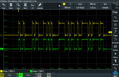

Now, I use the SPI6 instead of the SPI2, but a similar issue happening on the MOSI pin. When I use the PA7 as the MOSI, the signal amplitude can not reach 1.8V and occur unpredictable noise. But when I change top the PB5, the amplitude returns to normal level and the signal is stable. Is there a difference between these two pins?
Please refer to the pic below and the video in the attachment. The C1 is PA7 and C2 is PB5, the trigger level are all set to 500 mv.
These two pins setups are the same as below. And all enable the HSLV.

2024-10-24 1:36 AM
The PA7 is connected to U15 LAN8742A-CZ-TR as RMII_CRS_DV signals. You may need to remove R37 to check again the behavior on PA7. thanks!
