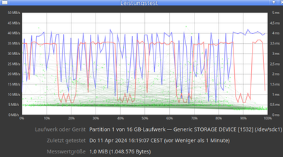

Ok, this is about 0,5...1ms on good , new cards. But after some use...times go up...see here a speed check:
on 2 y used Intenso 16GB card:
From general sd-card specification you have to deal with up to 100ms delay ! (over 300ms delay = defective).
"Cheap" cards (from China...) might run very good, but also very bad , is just rolling the dice .
So your program needs some buffering, at least to deal with 100ms (perfect: 300ms) "no reaction time" on R or W to card.
The debugger or 1 or 4-bit mode is not the basic problem, there is no other solution than to deal with the possible random delays. And try testing it with some used, old, cheap card - if it works with these, your program will work.
