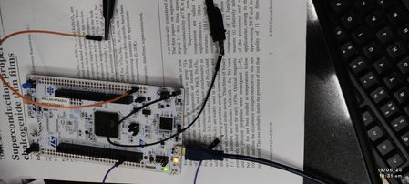

Right now across the VDD pin (CN11) and ground the multimeter shows 3.29V .But the oscilloscope probe in 10x shows 3.29V with the multimeter but the oscilloscope shows pk-pk :4V and max :2V, rms :2.92V.
Before once i had gotten 3.25V in the oscilloscope. I don't know why isn't it showing 3.29V today in the oscilloscope.

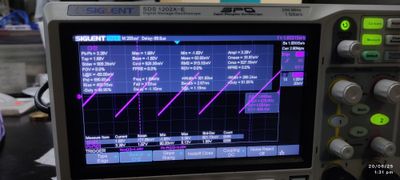

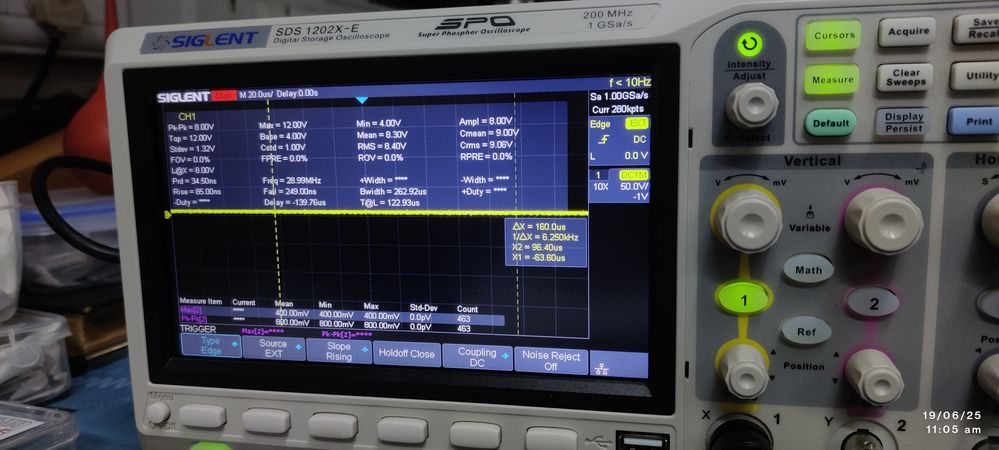

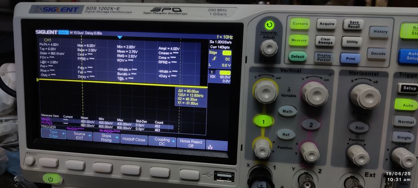

It feels like the board is giving a proper sawtooth .But i am unable to see that wave .The oscilloscope doesn't seem to have any problems either. But it failed to display the proper sawtooth with correct voltage.DAC oscilloscope.jpg There is any other way to verify this without the oscilloscope?
am i right?
waclawek.jan
Super User
You won't see a sawtooth waveform where period is some 10 seconds, on a 20us/div timebase setting of oscilloscope.
You also won't see 3V amplitude with 50V/div vertical setting.
You also may have broken ground pigtail on the probe.

Thankyou all.Issue is solved. Got a neat noise free sawtooth.
My trigger source was also set to external, so my wave wasn't stabilized.
The GND pin near the PA5 was also not that efficient.But the corner GND worked.
Yes, in my  oscilloscope i had set the wrong period and amplitude.
