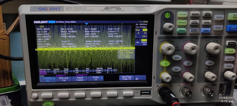

2025-06-18 10:53 PM - edited 2025-06-18 10:55 PM
You won't see a sawtooth waveform where period is some 10 seconds, on a 20us/div timebase setting of oscilloscope.
You also won't see 3V amplitude with 50V/div vertical setting.
You also may have broken ground pigtail on the probe.

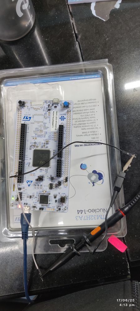

2025-06-16 11:51 PM
> no desired output signal (too much noise)
Show.
Also, what equipment do you use and how exactly do you connect ground?
2025-06-17 3:55 AM
thankyou for the reply .frequency coming in kHZ and MHZ
2025-06-17 3:56 AM
2025-06-17 3:57 AM
in CN7 pin no.8 for GND and pin no.10 for DAC (PA5)
2025-06-17 11:02 PM
Something is very wrong.
Try to connect the ground clip to the pins in the corners.
Try to connect the probe to GND, still noise?
Do you see this noise also when the processor is held in reset (simply by holding down the reset button)?
And what happens if you set one single voltage level in the DAC (say, 1/3 full scale) and then do nothing in the main loop?
Btw. you have set the oscilloscope to 10x probe but have the probe switched to 1x, so the numbers are off by factor of 10, but still the amplitude of that noise is baffling. There's also seldom any reason to use AC coupling when measuring on mcu pins.
