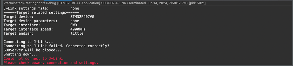

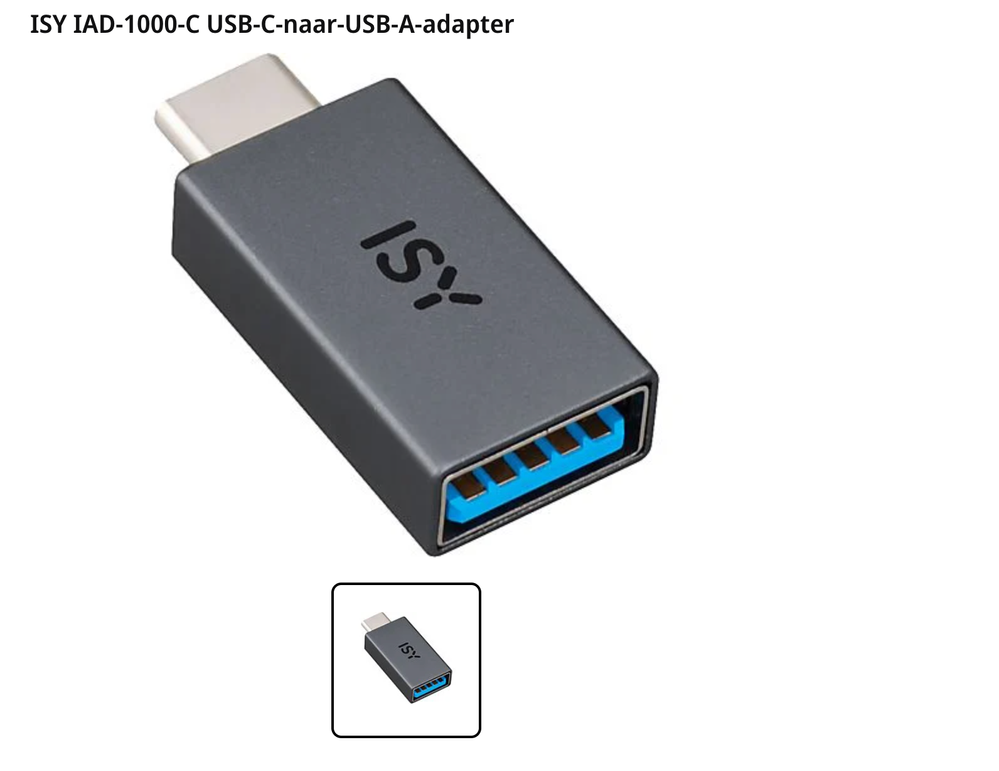

I am facing an issue when I run code in stm32f407. I am using STMCubeIDE in Mcbook pro m3 chip. Furthermore, I tried with different USB-C to USB -A adapters.  I can see the stm32f407 mounted. But, Jlink could not be connected.

USB-C to USB-A Adapter from ISY:

You are using stm32f407 discovery board having STLINK on it and you are trying to connect with JLINK? How?
Did you change the STLINK FW to support JLINK? or connected an external JLINK probe?

Thank you so much for quick reply. I didn't realize that I am not using ST link. I changed it in the debugger.
