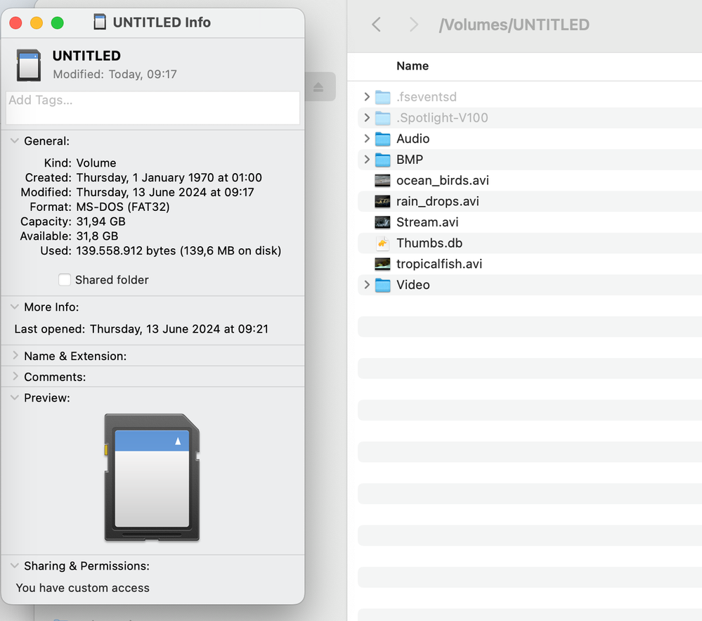

I've succeeded in programming the demo hen formatted a card as ExFAT (and also normal FAT) and copied the Media/ dir content onto the card.
Plugged the card but.. nothing. The main led stays red.
I've tried the Reset or Wakeup buttons, nothing.
Is there a step that I am missing?
Thx

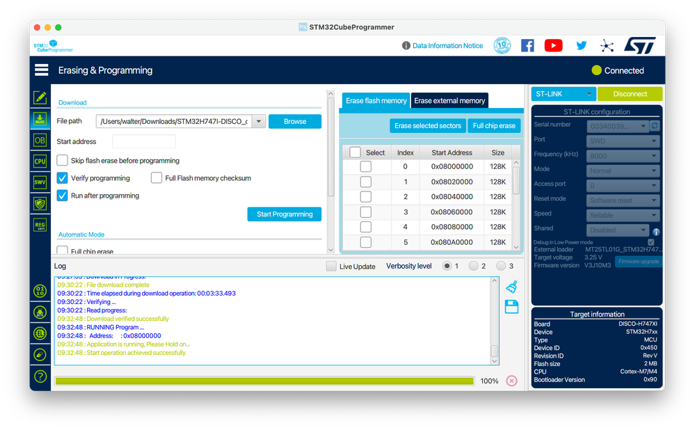

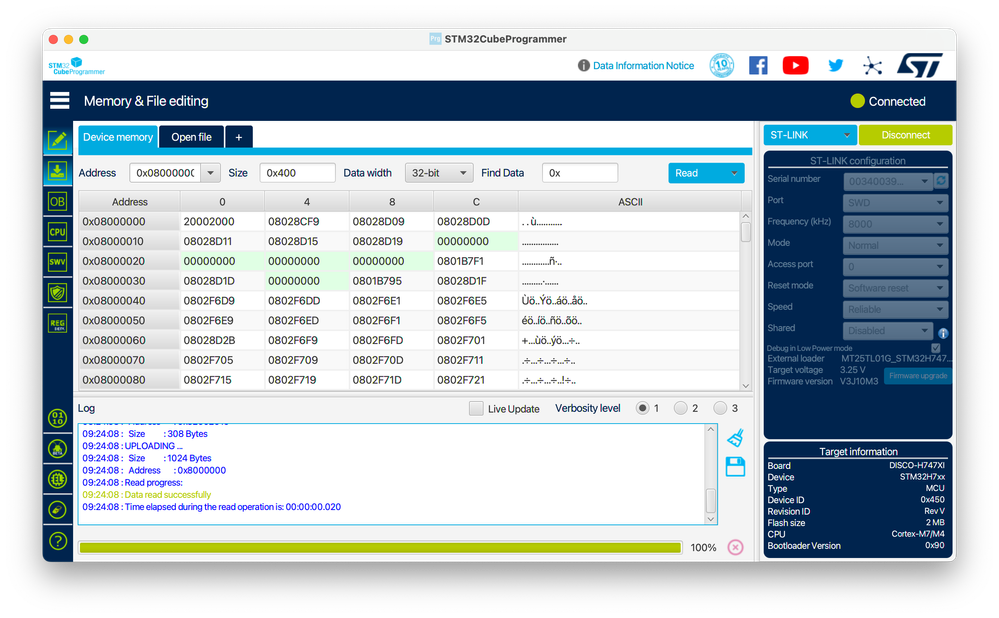

Yes, @FBL ,
it's only by using a usb-c HUB that I could plug a standard USB-A to micro-USB cable, and thus program the board.
The issue I have is that, after having successfully programmed the demo onto the board (at least that's what STM32CubeProgrammer wrote), nothing happened on the board. Screen was blank and remained blank.
What Can I do to check that the demo is installed and how can I make it "run"? Shouldn't it run when the board wakes up?
Maybe the SD card was formatted wrongly?
Regards
W

It is possible that SD Card is not formatted to FAT32. Make sure to use latest version of DEMO from STM32CubeH7/Projects/STM32H747I-DISCO/Demonstrations at master · STMicroelectronics/STM32CubeH7 (github.com)
Ensure your HW configuration is by default. Follow step by step demo readme to make it work.

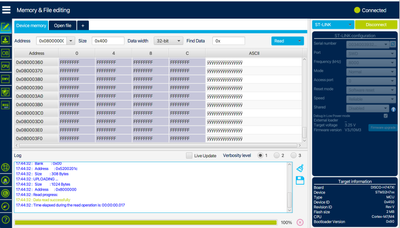

Hi @FBL ,
I've tried everything from scratch:
Everything is OK but nothing shows on the display. The main led blinks
Any idea on what I am missing?
There is something basic I think.. why the led blinks?
Thanks
W
2024-06-14 8:25 AM
Hi again @walterg
Unfortunately Demo binary is built for an old revision of the board and it is no longer maintained. Could you try the updates to support Dynamic ID? You need to update patch of CubeH7.
