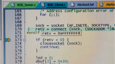

I checked the presence of 50 MHz in the "RMII_REF_CLK" circuit - such a signal is present.
The processor seems to work as it should, but network services do not work. For example, the BSD client does not connect.
It is not possible to examine the program code in more detail, since it is hidden in the library.
Apparently, I need to roll back to the frequency of 8 MHz.

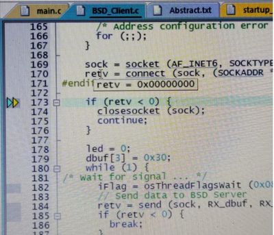

2024-10-02 11:41 PM
I've rolled back to the frequency of 8 MHz.
Network services are working again.
