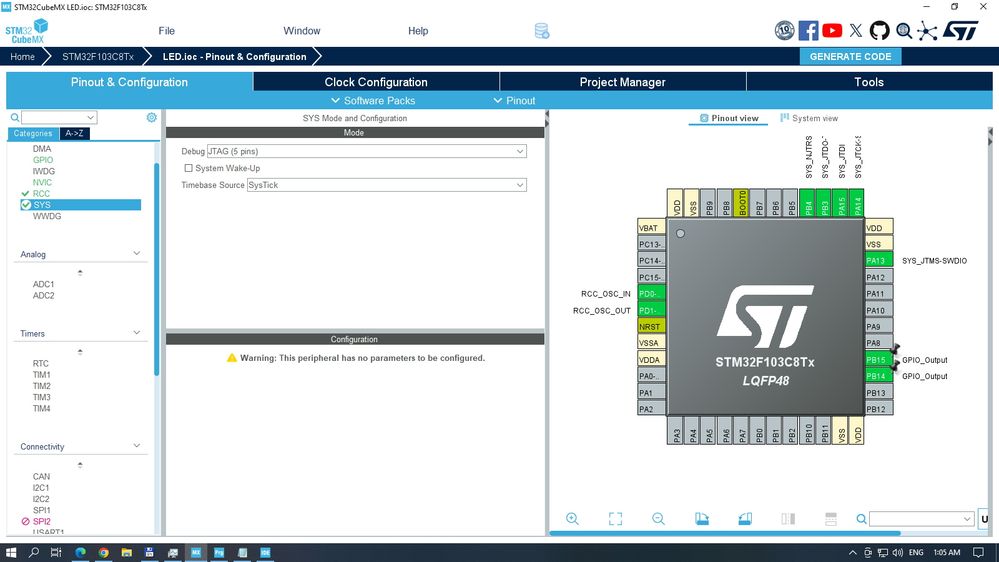

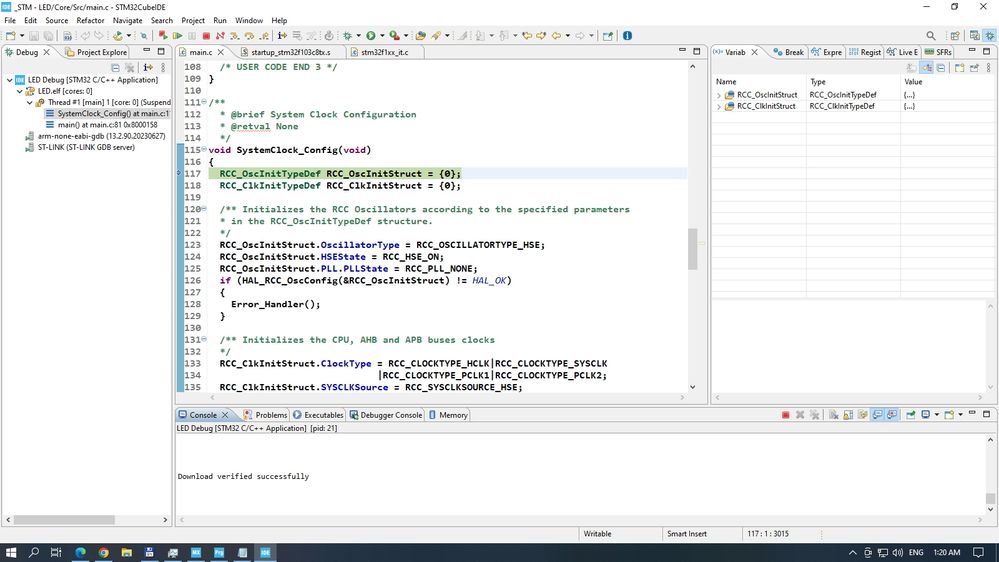

Debug mode is finally running after settings in CubeMX - see image below. I am able to use the "StepOver" and "StepInto" functions. I also re-set the frequency to 1000kHz. It is lower than 4000kHz.
Running in debug mode:

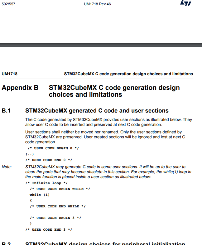

@JerryMC22 wrote:By the way if I am changing something in CubeMX in my project using the .ioc file (+GENERATE button) whole the main.c code is set to init state and everything I wrote to main.c is deleted (I am sad). It is suspicious. Is it possible to change the pin configuration in CubeMX without deleting the code I already wrote to main.c ?
That's a separate question - please start a new thread for that.
TL;DR you need to keep your code within the USER CODE section; eg,

@JerryMC22 wrote:I also re-set the frequency to 1000kHz. It is lower than 4000kHz.
Did you try 'Auto' ?

2025-01-29 3:35 AM
1/ I can not change the FRQ to any value. There in DropDownList and in it I see the following values: Auto, 100kHz, 1000kHz, 8000kHz, 24000kHz - it is the predefinned set. I can not put down my own value.
2/ If I am using set of several pins of my STM32F103C8T6 for JTAG purposes I can not use them for normal functions - it is a pitty, I am sad. :(

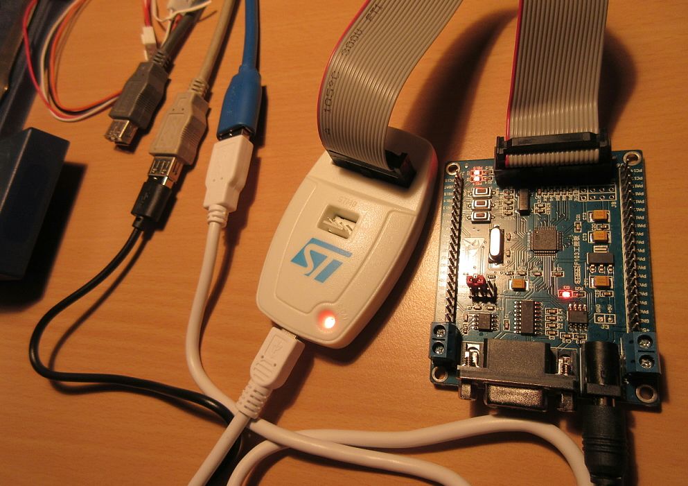

I know, I have this:
2025-01-29 3:48 AM
yes STM32C0116 very nice 278CZK without TAX 21% and without postal charge 130CZK = 466CZK too expensive.

2025-01-29 3:52 AM
the "Auto" set the FRQ to 4000kHz.
