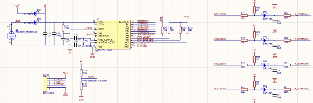

My controller still consumes 360µA in STOP mode, i can't figure out why.
Maybe one of the inputs/outputs that leaks current?
I have this IO setup the moment i execute STOP
PA0-PA5 = External interrups up down edgle no pull up of down
PA6 = ADC input
PA9,10,14 = input mode no pull up or down
PA7 = External interrups up down edgle no pull up of down
PB1 = input mode no pull up or down
PB9 = input mode
