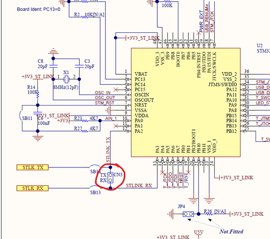

Check with an oscilloscope to see if the PA2 is transmitting. Then you can determine if it's on the STM32L476 side or VCP/Tera Term side that has an issue.
Another thing you can try is to do a loop back test on the VCP. Make sure the STM32 is erased else you won't be able to test the loop back. Place a jumper CN3. You should be able to send some text from Tera Term, and you should see text echo back.

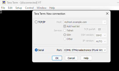

Double check the COM port number. In TeraTerm serial config dialog, the bottom panel should display "ST Microelectronics ..."; it doesn't - you are configuring another port in TeraTerm, not the Nucleo VCP.
