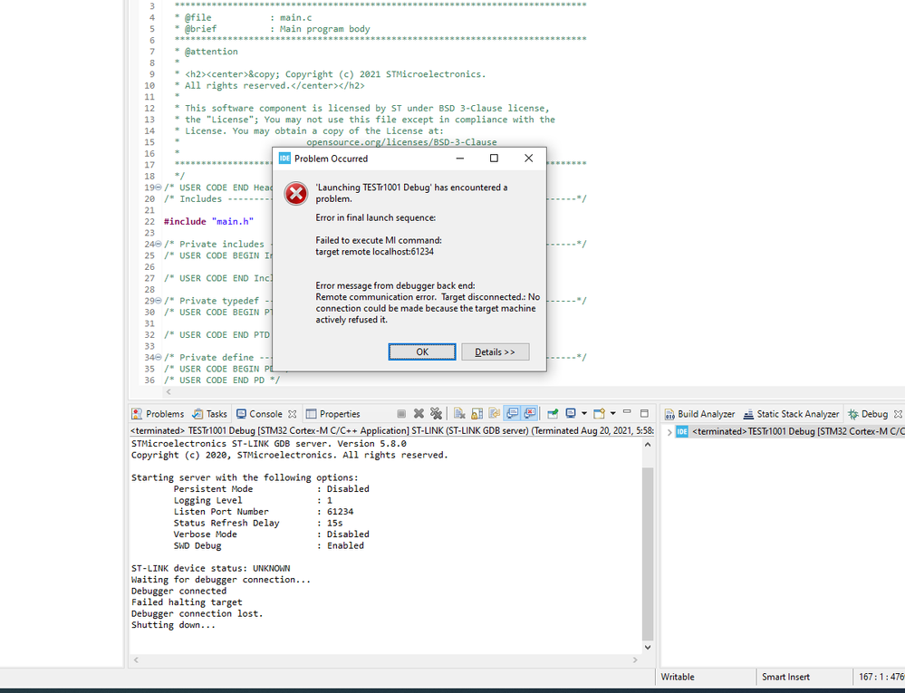

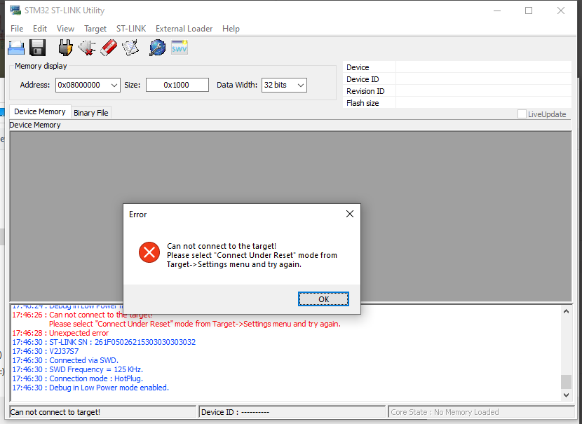

Update on the current issue (STM32H7 STlink-v2 programmer to breakout board ). it seems i can connect but the chip is not responding. here is the results from the STlink software tool. What am i missing ?
And the next is the results from the cubeIED

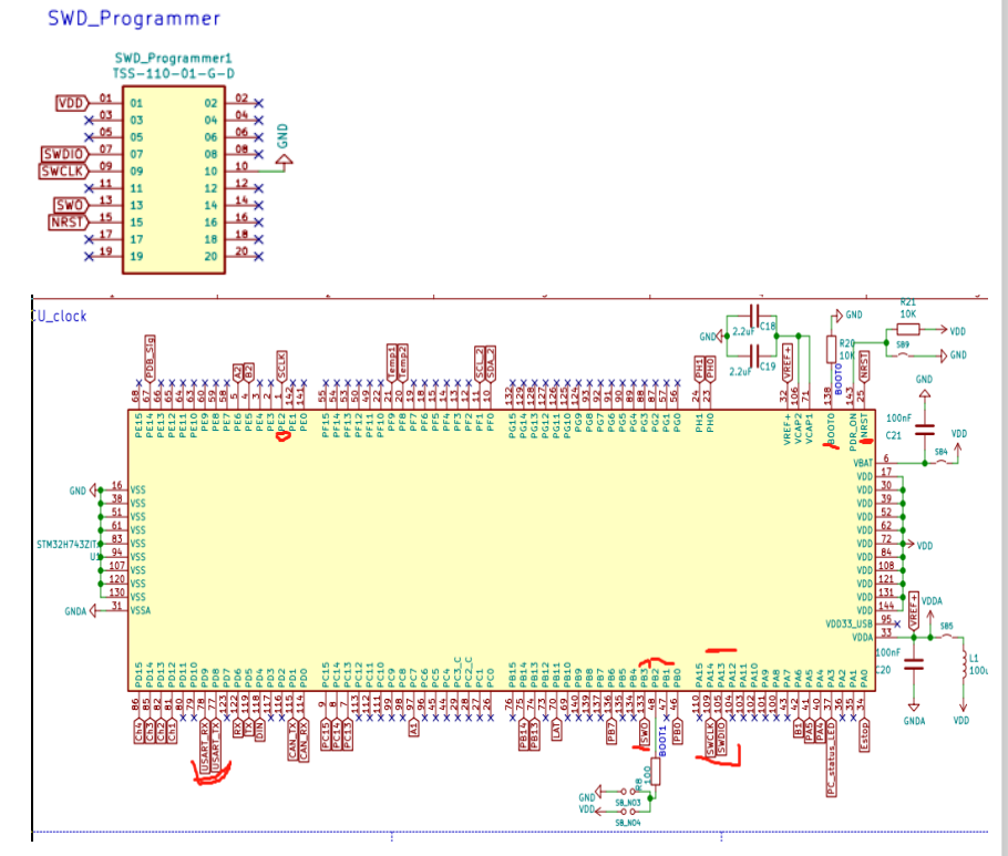

Hi @Community member thanks for your quick response, I forgot to mentioned that NRST PIN was connected. I have attached the schematics bellow. the only test I did was to check the VDD powering the board with 3.3V and i have tested the VCAP pins with 1V, as for the USART, only the USART3 pinout is available on this breakout board.

Do you use the standard debugging tool (external STLink/V2 programmer). The SWD Programmer connector from schematic isn't the stardard one.
