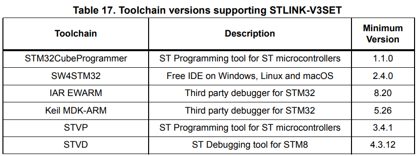

I am designing a firmware for STM8 MCU using the ST visual develop tool.
I know that the ST-LINK/V2 worked with the ST visual develop.
However, if I can use the STLINK-V3 instead of the ST-LINK/V2, I would like to get it for better performance and for additional useful interfaces.
2018-11-30 3:35 AM
It was described in the User's manual as the attached picture.
