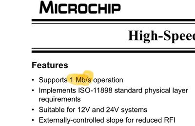

2024-03-22 9:34 PM - edited 2024-03-22 9:40 PM
You can use it if your CAN bitrate doesn’t exceed 1Mb/s according to your tranceiver’s datasheet:
