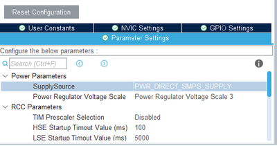

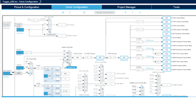

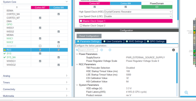

I want to use Nucleo-H745ZIQ board with operating clock at 480 MHz for M7 and 240 MHz for M4. Below is the clock configuration.
Under RCC, options are either PWR_LDO or PWR_EXTERNAL_SOURCE_SUPPLY selection enabled. Voltage scale as Power Regulator Voltage Scale 0.

2023-07-06 11:33 PM
set rcc to PWR_LDO and try.

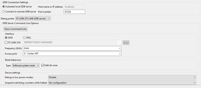

use set debug :
is normal debug connection working ?

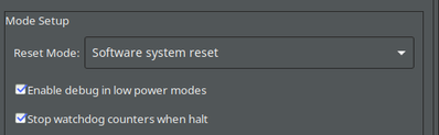

2023-07-07 1:35 AM - edited 2023-07-07 1:36 AM
Debugger setting... Software system reset
Normal debug is working if I set clock frequency to less than 100 MHz and with below set up

But still facing the same issue. Could you please suggest clock configuration required to operate the board with maximum speed i.e. 480 MHz
Nikhil
