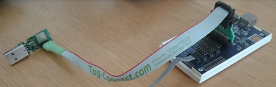

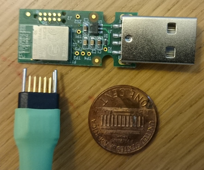

To add to Andrew's observation, Tag-Connect has grown popular as a means to do SWD connection on STM32 and similar platforms.
2024-03-23 3:04 AM
@Tesla DeLorean wrote:Tag-Connect has grown popular as a means to do SWD connection on STM32 and similar platforms.
Indeed it has!
I remember meeting the inventor when he was over here first promoting it back in 2010!

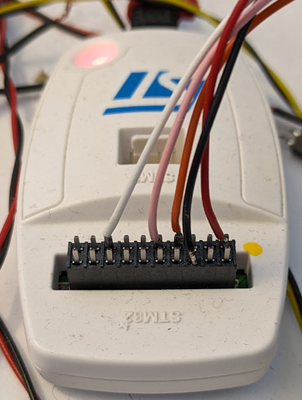

Easy. Just get a new ST_Link V3 and wire up anything to its open contacts.
2024-03-23 7:16 AM
not that it's hard to wire up a custom connection to a standard St-Link:
8)
