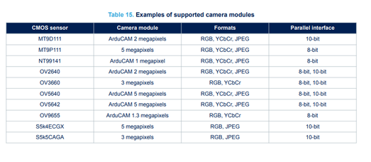

->Do I understand correctly, that MB1683 (B-CAMS-OMV) is only the adapter board
There is a wide range of camera modules and CMOS sensors that are compatible with the STM32 DCMI.
The table below lists some of them.
The B-CAMS-OMV is an example of compatible module with STM32 DCMI.
To know if a CMOS sensor (a camera module) is compatible with the DCMI or not, the user must check the following points in the CMOS sensor specifications:
• Parallel interface (8-, 10-, 12-, or 14-bit)
• Control signals (VSYNC, HSYNC, and PIXCLK)
• Supported pixel clock frequency output
• Supported data output

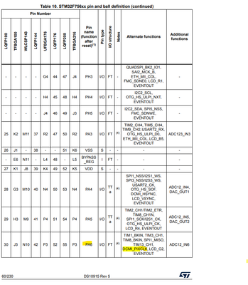

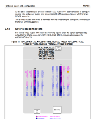

First of all you need to refer to STM32F756 datasheet and check all required pins for camera module (DCMI_PIXCLK, DCMI_HSYNC, DCMI_D0.....) are supported or not in STM32F756. If yes, you can use jumper wire to connect camera module CN4 pins with desired pins in Nucleo board by referring to UM1974 Figure11.
For example, you can find DCMI_PIXCLK on PA6

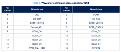

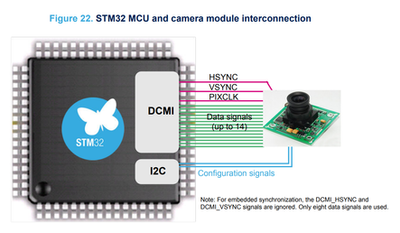

As shown in the below figure, the camera module is connected to the DCMI through the following signal types:
• DCMI clock and data signals
• I2C configuration signals
For that, it is necessary to refer to the Camera module and to the board Schematics and MCU datasheet and check the required pins for this connection.
You can used B-CAMS-OMV module with STM32MCU have a DCMI peripheral.
To find the required pins used to connect B-CAMS-OMV module with an MCU you can refer to UM2779 or S5k5CAGA.
For B--CAMS-OMV , this connection made with CN4 connector as shown in the below table.

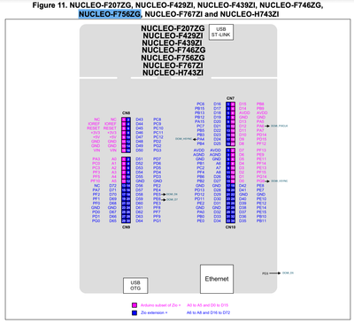

2026-02-03 2:05 AM
Hello Kaouthar,
thanks for your thorough guidance on this.
In the STM32F6 datasheet I found all pins required for the camera. And most of these pins also appear in the extension connectors of the Nucleo-F756ZG board (see image).
However, in the STM32F6 the pin DCMI_D0 is linked to PH9, which strangely doesn't show up anywhere in the Nucleo-F756ZG...Is this an indication, that I should use the alternate pin PC6 with this particular board?
