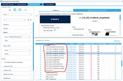

2026-02-02 9:02 PM
It would be better to start from a working example that has consistent set of code and library versions. You can select from a a few of them using the Example Selector in STM32CubeMX.
2026-02-02 9:02 PM
2026-02-02 9:12 PM
Do you know if any of these work on the version with the blue pcb? I read somewhere that there was no software examples for it but also that post was 2+ years old
2026-02-02 9:39 PM
I just verified that they do, thank you!
